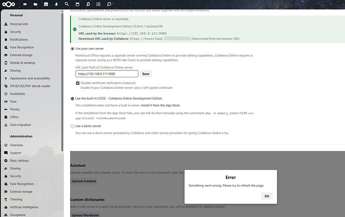

Collabora and Nextcloud is configured like this:
This way is the closest to working. The office files even have preview thumbnails in Nextcloud.
The error message when I try to open any office file format from Nextcloud:
Error - Failed to open the requested file.
